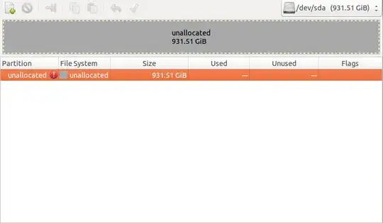

UPDATE 2: Upong running GParted I get the following message:
/dev/sda contains GPT signatures, indicating that it has a GPT table. However, it does not have a valid fake msdos partition table, as it should. Perhaps it was corrupted -- possibly by a program that doesn't understand GPT partition tables. Or perhaps you deleted the GPT table, and are now using an msdos partition table. Is this a GPT partition table?
And here is a screenshot from GParted. enter image description here

I fixed the problem easily using the FixParts package. It simply removed the leftover GPT data on the HDD from the previous partitioning.
