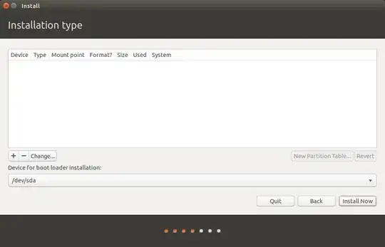

2) My second advice would be that you repartition your disk straight from Windows (as it won't allow you to touch to Windows partitions (OS, recovery,...)). Make sure you leave some unallocated space equal to the amount of space you want to use to install Ubuntu. If not done, create your USB first. If you have a CD drive, buys DVDs (it is ANNOYING but saves your from so much trouble. I have lot's of experience when it comes to installing Ubuntu in the cleanest way possible) and burn DVDs of Ubuntu images. Boot from either the UBS or the DVD, and proceed with the installation. Now, this is when the hardest part comes in: selecting your installation mode.
When you arrive to a step when you have to choose between ERASING your disk and SOMETHING ELSE, choose SOMETHING ELSE. Then, recognize the unallocated space you created in Windows. Create and ext4 file system out of it, format it (again :) and mount it as "/". If you want to add swap, add it. Add anything else you want to. Also! This is important if you boot in UEFI mode (USB or DVD). Make sure you have your efi partition on (the same used by Windows). Don't delete it! Don't format it, use it as EFI partition!
