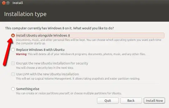

Take a look at Install Ubuntu 13.04. Actuality during the Ubuntu installation you have the option to install alongside Windows 8.
For 12.04, if you don't see the option to Install Ubuntu alongside Windows 8 (probably won't), then make sure that you have the partition ready, in windows before hand (it doesn't have to be formatted), and choose something else. You will have the option to create the needed Ubuntu partitions, create two partitions: the first for /, the root directory, and the second for Swap.
