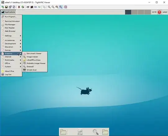

I have successfully installed WLS (ubuntu 18) on windows 10 machine. I want to access its UI features using TightVnc. With default settings the .vnc/xstartup contains the following lines
xrdb $HOME/.Xresources
xsetroot -solid grey
#x-terminal-emulator -geometry 80x24+10+10 -ls -title "$VNCDESKTOP Desktop" &
#x-window-manager &
# Fix to make GNOME work
export XKL_XMODMAP_DISABLE=1
/etc/X11/Xsession

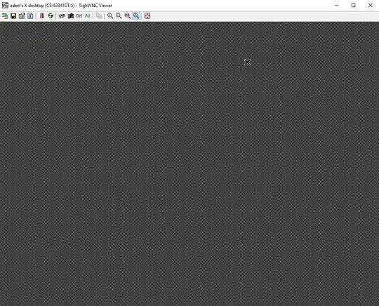

and I can connect to it using Tight vnc viewer from windows but the UI looks like enter image description here But, I want to use the default desktop that ships with Ubuntu 18. I installed gnome and changed xstartup file to the following (suggested by someone on the web)
#!/bin/sh
#Uncommment this line if using Gnome and your keyboard mappings are incorrect.
#export XKL_XMODMAP_DISABLE=1
# Load X resources (if any)
if [ -r "$HOME/.Xresources" ]
then
        xrdb "$HOME/.Xresources"
fi
gnome-session --disable-acceleration-check --session=ubuntu &
But when I start vncserver after making these changes, I am able to connect but it shows a grey screen with no visual controls like enter image description here Please note that I had no .Xresources file on my machine so I created an empty one manually but it made no difference. Below is the output of ls /usr/share/xsessions
ubuntu-communitheme-snap.desktop  ubuntu.desktop  xfce.desktop
I can see some errors in .vnc/CS-63341DT:5.log file. Below are the contents of this file

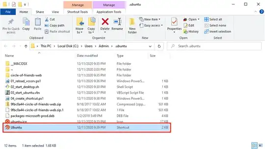

Open the Ubuntu Directory: Copy the command from below these instructions Paste the command into PowerShell Press "Enter"
cd c:\users\admin\.ubuntu
Create the Shortcut: Copy the command from below these instructions Paste the command into PowerShell Press "Enter"
powershell.exe -file .\04_create_shortcut.ps1
Open the Directory in Explorer: Copy the command from below these instructions Paste the command into PowerShell Press "Enter"
explorer .
Launch the Ubuntu Desktop: Double-click the "Ubuntu" shortcut
