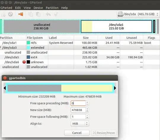

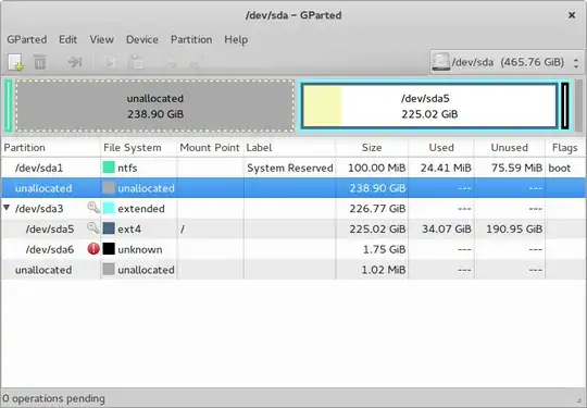

I have recently unallocated the windows partition in my pc to free the disk memory but i am not able to allocate the unallocated space made by deleting the windows partition this is a screenshot of Gparted editor which shows what i have done enter image description here
how can i allocate the unallocated space created and then i would like merge that partition into ubuntu partition without eventually loosing the data present in ubuntu partition.

let me see if I can help you. First you need to know something about LiveCD and GParted.
When using the LiveCD/LiveDVD/LiveUSB, GParted will be installed by default, so there is no need to install it in the Live Medium. This is different if you are using an installed version of Ubuntu in which GParted will not be installed by default, so you can only use GParted right away from the Live Medium but you need to install it in Ubuntu if you are running Ubuntu from an already installed scenario.

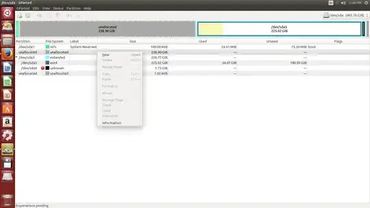

With this in mind, run the LiveCD/USB of Ubuntu and open GParted. I assume you read the Using GParted to remove windows partition on how to resize (Dragging the yellow bar for example). What we do now is, in your case, select the Locked partition inside the Extended partition (in your case sda5) as shown by the Gray KEY icon. Right click on it and select Unmount, Disable or any other option that appears that unlocks it.

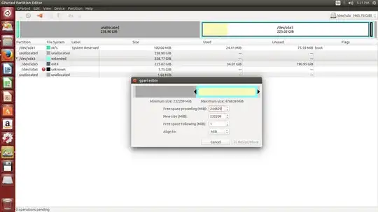

After that, simply select the Extended Partition, right click on it and select Resize. you should be able to resize it this time.

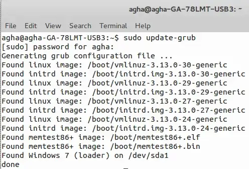

Looking at your EDIT 5, here are the steps you need to do to remove Windows 7 and be able to boot afterwards:
  1. Delete the SDA1 partition and set the SDA5 to boot with the boot flag parameter
  2. Boot from a Live CD and run boot repair as mentioned in Installing Ubuntu Alongside a Pre-Installed Windows with UEFI This will make sure you boot from your Linux partition AND remove windows 7 from the boot list

/dev/sda3 is an extended partition - to gain accesses to the unallocated space, /dev/sda3 has to include it first. To do this, boot from a live USB.
Install gparted on the live USB sudo apt-get install gparted
Use gparted to expand the size of /dev/sda3 to include the unallocated space.
Use gparted to expand the partition /dev/sda5 into the unallocated space which is now incorporated in /dev/sda3
Shutdown your computer, remove the USB, and startup again
