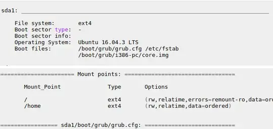

Install GRUB on /dev/sda instead of /dev/sda(x) like this :
sudo grub-install /dev/sda
Normally this should fix your problem, if not you can use bootrepair again. Also you can use GRUB Customizer to edit the bootloader.
It should be like this : enter image description here
