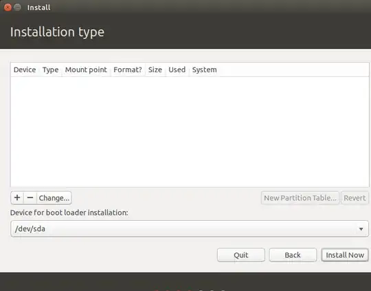

It runs fine (although in a 800x600 resolution), but when I reach the step where the installer asks for partitions, this is what I see (completely empty list of partitions):
I don't know how to proceed.

Fixing the backup GPT solved the issue.
In order to fix it: run "sudo gparted", and click FIX when it reports the problem about the backup GPT and proposes to fix it).
