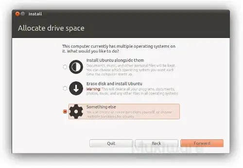

Then: Nothing special is required if you use the automatic installer of Ubuntu ("Install Ubuntu alongside others" or "Erase the disk and install Ubuntu"). Important: if you have a pre-installed Windows and you want to keep it, do not choose "Erase the disk and install Ubuntu".
If you use the manual partitioning ("Something else"), the difference is that you will have to set the /boot/efi mount point to the EFI partition. And if there was not any EFI partition on your HDD, you first will have to create it (see the "Creating an EFI partition" paragraph below).

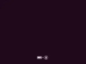

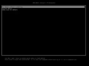

When booting on a 64-bit Ubuntu disk:
  • If the BIOS is set up to boot the CD in EFI mode, then you will see the screen below:
  • If the BIOS is NOT set up to boot the CD in EFI mode, or if the disk is not 64-bit, then you will see the screen below:

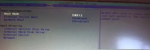

Some recent computers (>2011) allow to set up the boot either in UEFI mode or in Legacy (not-EFI) mode. The way to carry out this setting depends on the computers, but generally this setting is located in the "Boot order" tab of the BIOS (to access the BIOS screens, it is generally necessary to press a key during the PC startup).
Note: Some BIOSes (e.g. American Megatrends' "Aptio", found on the Asus vivobook series) call Legacy mode "Compatibility Support Module" or simply "CSM".
Remark: Some BIOSes allow one to set up the boot mode for the optical drive separately from the boot mode for the HDD.

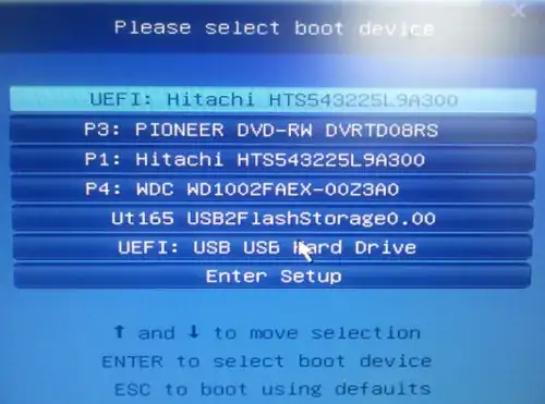

For example, below:
The "UEFI Hitachi" line allows to boot the HDD in EFI mode,
The "P1: Hitachi" line allows to boot the HDD in Legacy (not-EFI) mode,
The "P3: DVD" line allows to boot the Ubuntu CD in Legacy mode
The "UEFI: USB" line allows to boot the Ubuntu liveUSB in EFI mode.
Here is a 2nd example of BIOS, simpler, where the "Boot Mode" parameter allows one to choose the boot mode ("UEFI" or "Legacy") for all media (hard disk, CD, USB...) at the same time.
Some other firmwares (BIOSes) propose an "UEFI/Legacy Boot:" option with the following choices: [Legacy only], [UEFI only] and [Both]. This last one boots in EFI mode when possible, then in Legacy mode if no EFI files are detected.

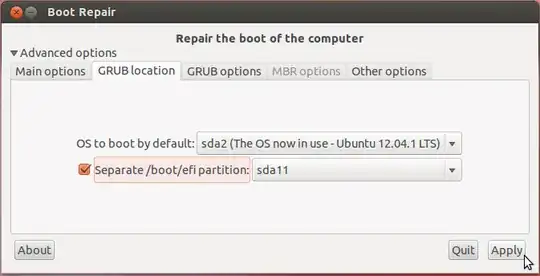

Start Boot-Repair, click on "Advanced options", go to the "GRUB location" tab. If you do not see a "Separate /boot/efi partition" line, this means that your PC does not have any EFI partition. In this case, exit Boot-Repair, then create an EFI partition (see the "Creating an EFI partition" paragraph above). If you see a "Separate /boot/efi partition" line, tick it then click the "Apply" button.
Set up your BIOS so that it boots the HDD in EFI mode (see the ""Set up the BIOS in EFI or Legacy mode" paragraph above).
