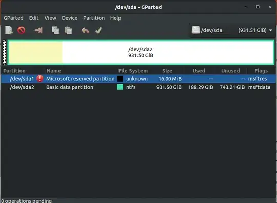

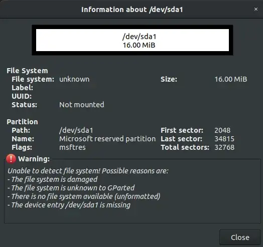

I had no problems until I decided to switch from Manjaro to Ubuntu. Now my bootloader doesn't "see" Windows anymore but I can access the file system from Ubuntu and see that everything is still there and intact. I tried os-prober and updating grub but it didn't do anything. I also noticed that when I open that drive in gparted, I get a red exclamation mark next to the Windows boot partition.

I believe you actually have a host of issues that are contributing to your problem. I'm basing this on the info you posted related to the partition tables you included about the hard drive where Windows currently resides.
Here are some of the potential issues. Your problem could be one or more of these:

  • GPT/UEFI and MBR/BIOS are not compatible with each other when you dual boot. Since this is a new (2019) PC, there shouldn't be any operating systems pre-installed in legacy/BIOS mode with an MBR partition scheme, but for some reason, it appears this is how Windows was installed on your system. Since you are using a modern OS, the best path is to actually make sure that Windows is installed as UEFI. You would need to format (erase) the Windows hard drive as GPT (NOT MBR) and rerun the Windows installer. Windows will install correctly as UEFI and automatically set up proper UEFI boot partitions as long as you start the Windows installation when the drive is newly formatted (empty) using the GPT partitioning scheme.
  • If you don't want to have to reinstall Windows, you will need to install Ubuntu in "Legacy/BIOS" mode, which usually involves altering a setting on your motherboard BIOS to allow booting the flash drive as Legacy/BIOS. You will still need to format the disk where you intend to install Ubuntu prior to launching the installer.
  • When installing Ubuntu with Windows already installed, there should be an option to "Install Ubuntu Alongside Windows" - if this option is not listed, there is an issue with your current configuration and it's unlikely that GRUB will be installed correctly with Ubuntu and Windows as options.
  • The 16 MB MBR partition associated with your Windows installation is also quite small, so it might not be enough space to install GRUB and all of the files needed to boot both Windows and Ubuntu. To alter this, you would also need to format that hard drive (and reinstall Windows).
