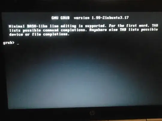

However, my problem is: When I run windows or Ubuntu, shut down computer, and turn it on again there is a grub program, which seems to not be able to see any OS:
What is interesting, I just have to enter the bios (don't even have to do anything except save & exit) and after restart there is normal grub purple screen with boot options, from which I can start Ubuntu and Windows. But when I turn it off, the problem recurs. Moreover, in bios, in boot options, I can see: my ssd, and TWO positions with Sandisk ultra fit (the same) - even if I delete one of Sandisks, the next time I enter BIOS there are all three options again.
Can anyone tell me what's going on? I can live with this, but it's boring to enter bios every time when turning my machine (ASUS us303, if it helps) on. Also, I'll be grateful if you could advise me how to partition my USB stick in case I need re-installation.

Just wanted to let you know that I solved this by disabling fast boot in BIOS.
I also reinstalled Ubuntu precisely using the instruction from link above, and it works great.
