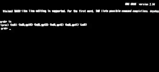

I am trying to install Ubuntu alongside Windows 11. I installed Ubuntu with Rufus on a USB flash drive. I put it in the boot sequence in the BIOS. Instead of launching the Ubuntu installation I have what you see in the screen photo. I did ls it showed me what you see in the photo.
When I boot the Ubuntu live USB only what you see in the screenshot appears. Install Ubuntu or other options don't appear when I boot the Ubuntu live USB.

Disable TMP as well as Secure Boot in the UEFI ( what some people still uncorrectly call BIOS ).
Also disable fast start up in Windows.
When you are in the Live environment click the install Ubuntu icon on the desktop.
Make sure all your hardware works in the live environment.
