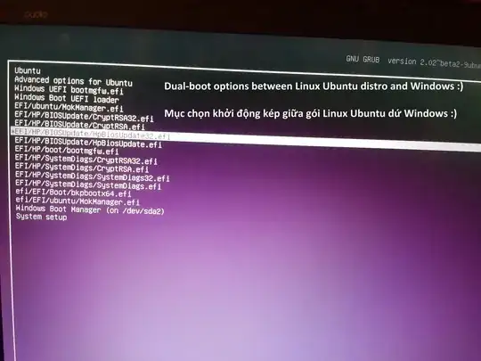

You don't have to disable anything. I had this problem yesterday, and was able to fix it, now I can choose which OS I want to boot to. Below are the step.
You can boot to Linux as a live user or if you can from your installed Linux, either way, try to start Linux. Make sure you are connected to the internet.
Then type these commands one by one
sudo add-apt-repository ppa:yannubuntu/boot-repair
sudo apt-get update
sudo apt-get install -y boot-repair && boot-repair
Then when you see a dialog appear, select "Recommended Repair". Then just follow the wizard. NOTE: you might or might not receive an error something like this "Secure Boot Error" which I did receive, don't worry, just keep proceeding as normal, no need to do anything about it. Then by the end you will see a success dialog telling you to write down a link, just read that dialog carefully. Then don't forget to write down the command at the end of that dialog or you can take a picture of it with your phone like I did. Just follow the instruction provided in the dialog. when you have done everything like I suggest. You will see this screen every time you boot your computer.
:) Dont mind the text on the image, I was just showing off my new dual OSs to my friends :). Hope this helps you enter image description here
