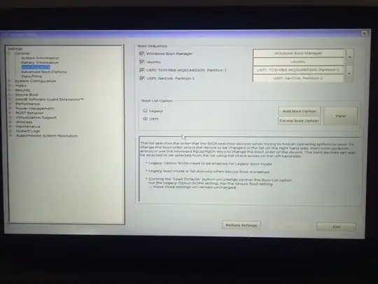

I have made sure the UEFI mode is selected and not legacy. Secure boot is off. Fastboot is turned off.

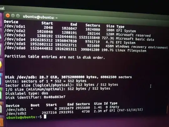

There is one partition(sda 6 for ubuntu). sda 1 EFI for as windows boot manager(And assuming that grub will be installed here). I am using live usb to install Ubuntu.
I have also tried with and without a new EFI drive sda4. Please help me resolve this and get Ubuntu 16.04 installed

UEFI Boot selected
partition list

I experienced the same problem while trying to install Ubuntu 14.04 alongside Windows 8.1 Pro. However, make sure you uncheck Turn off secure boot, and then reboot your computer. After that press F8 or F2 depending on your computer, then make sure you boot in UEFI and not Legacy.
