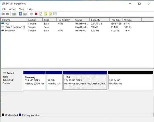

  1. made space for Ubuntu to install using Disk Manager in Windows: Picture of partitions

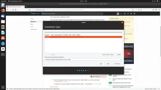

  4. When I go through the installation I don't see the window where you can choose installation type (I.E. "Something else"): it just goes through and the only disk that I can install Ubuntu to is that USB with an image.
The screen where I get stuck:
the screen where I get stuck

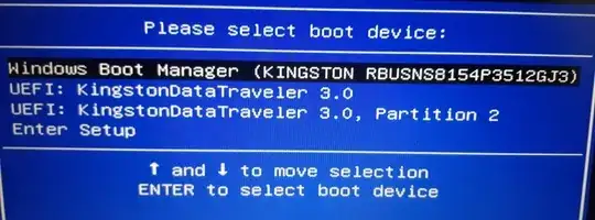

  1. I updated the BIOS/UEFI. After that when I choose "try Ubuntu before installing" it first shows Ubuntu loading screen and then I see this: Picture of what I see
Questions:
  1. Can someone confirm I boot from UEFI mode? Can someone confirm I boot from UEFI mode?
