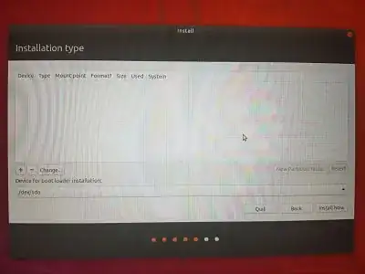

I'm trying to install Ubuntu 18.04 with Windows 10. I created the partition in Windows and installed Ubuntu in a USB using Rufus.
Then I accessed the BIOS to start from the USB and install Ubuntu. When I restart and start installing it, I introduced the language, the wifi, and marked the "normal installation" option, but the next frame is this one:
ubuntu_installation
There should have been my partition made on Windows, but it is empty. If I click on "+" or "change" it just crashes, and just tells me "install Ubuntu is not responding".

I solved it! The problem was the SATA mode option in the BIOS. It was set to RAID, and changing it AHCI made it work.
Hardware information of my pc (just in case you have the same):
LENOVO Ideapad 720s-14IKB Intel Core I7-8550U Kaby Lake (Quad Core, 1.8GHz - 3.7GHz, 8MB Cache). RAM: 8GB DDR4 2133MHz Storage: 512G SSD M.2 PCIE
