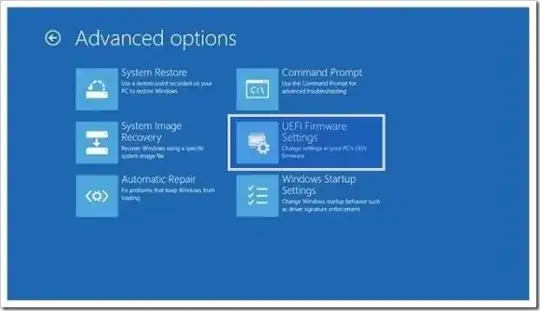

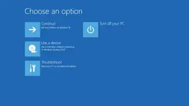

I suspect that you still have SecureBoot on, and this causes Windows 10 to boot up regardless of the OS installed. You'll need to disable it within your BIOS, and swap the bootloader. In Windows 10, hold the SHIFT key while tapping or clicking on Restart, available from any Power icon.
Select Troubleshoot and UEFI Firmware Settings.
Navigate your way to "Boot" (since BIOS is different for each computer). Swap the "Windows-Boot(anything related to Windows) with the Ubuntu one(can't remember the name. So your boot should look something like this.
