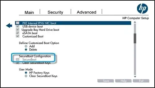

Next, disable secure-boot
Immediately press the Escape key repeatedly during startup, about once every second, until the HP Computer Setup opens. (I think you have to press F10 here)
Then, on the Advanced tab, use the down arrow key to select Boot Options, and then press Enter.
On the Boot Options page, use the down arrow key to select Secure Boot, press the Enter to uncheck the box if it is already checked.
Click Save to save the change. Then click yes.
The Computer Setup Utility closes and the computer restarts.

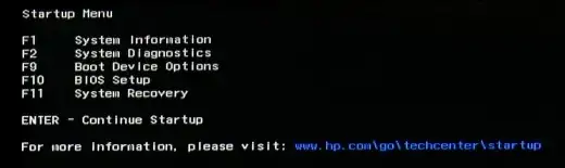

Next, immediately press the Escape key repeatedly during startup, about once every second, until the Startup Menu opens.

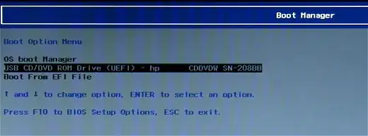

Press F9 to open the Boot Device Options menu, use the up or down arrow key to select the USB CD/DVD drive, and then press Enter. The computer starts Windows.
Insert the bootable USB, CD, or DVD into the CD/DVD drive (or USB plug) and then press the power button to turn the computer off, wait about five seconds.
Finally, press the power button again to turn the computer on and the CD DVD or USB should startup bootrepair.
