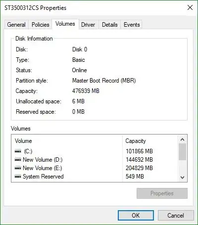

Step 2: Check the hard driver partitioning type (GPT or MBR)
Now in the Disk Management, to look the partition style of your hard drive, do a right click on the disk and choose the properties
Then go the Volume tab.
If it shows GUID Partition Table then your Hard Disk partitioning is GPT.
If in your case it shows Master Boot Record then your hard drive partitioning is MBR.

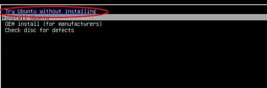

A GRUB menu will appear.
Select the option Try Ubuntu without installing.

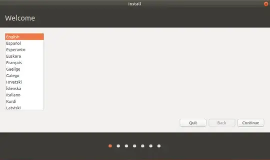

Choose the language. Click Continue.

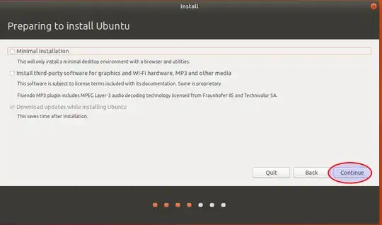

We are going for full installation. So we will keep Minimal Installation unchecked and continue.

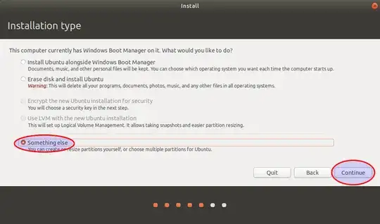

For manual installation click Something else and continue.

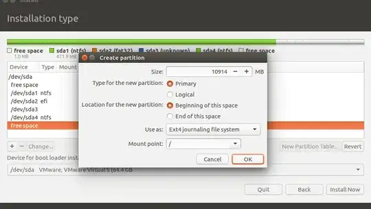

On this step we’ll create our custom partition layout for Ubuntu 18.04. On this guide will recommend that you create two partitions, one for root and the other for home accounts data and a partition for swap (use a swap partition only if you have limited RAM resources or you use a fast SSD).
To create the root partition select the free space (the shrink space from Windows created earlier) and hit on the + icon below. On partition settings use the following configurations and hit OK to apply changes:
Size = at least 15000 MB
Type for the new partition = Primary
LocatioStart menu n for the new partition = Beginning of this space
Use as = Ext4 journaling file system
Mount point = /
