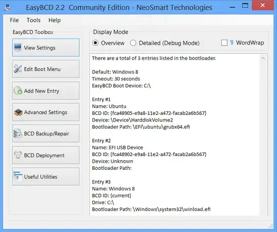

I have a dual-booted Windows 8-Ubuntu 13.04 system. As usual, by default, the Ubuntu grub menu comes up as soon as we boot. Similar questions have been asked before, and the reply to each of them was Grub Customiser and EasyBCD. My problem is that as soon as I restart my system, the changes in EasyBCD installer get reverted. Please provide me with a solution to this.
This is my boot-menu as in EasyBCD:
Now I go to the boot menu, set priority for Windows 8 the highest and in BCD deployment hit 'Write MBR'. Yet, when I restart, no changes take place and it reverts back to the same order.

This is not gonna happen. I doubt that windows startup manager will see ubuntu partitions. It may but it will take you searching and playing around with settings. Rule of Thumb is : install windows first, install Linux after, allow Grub overwrite MBR and use grub. I guess this is not the answer you were looking for... ?
