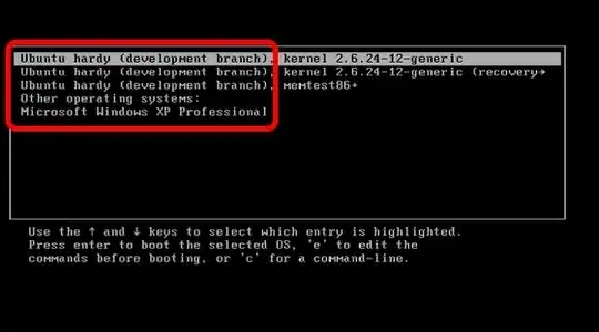

You will be provided with a OS selection menu ,the Grub2 menu from which you can select the OS to which you want to boot into.Ubuntu will be the default OS but it can be changed to Windows if you like it that way.
Check out the following image of Grub2 (Ubuntu + Windows XP)
