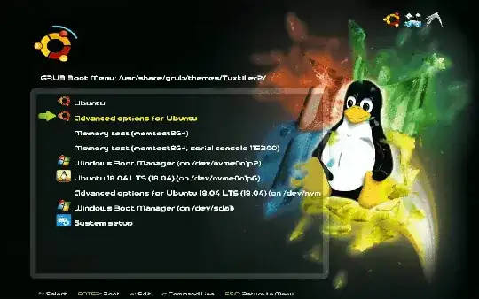

TL;DR
Most people recommend switching from the default Intel RST to AHCI. I've found that both work however.
I did change BIOS to not reload from hard disk each boot which saved 4 seconds or so. I also changed BIOS to not read from NIC cards which saved a few seconds. BIOS POST used to take about 16 seconds and I trimmed it down to 5 seconds. Still too long I think because Dell Inspiron 17R 7720SE is only a second or two.
In BIOS make sure TPM and secure boot is turned off. Also you might want to follow boot-repair suggestion to move partition to front of disk:

As you can see both Windows 10 on SDD and HDD appear:
