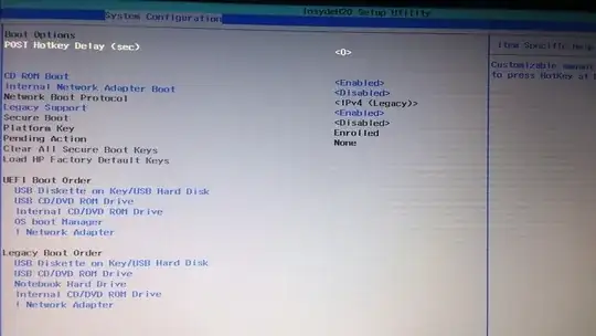

I own HP J110TX Laptop running Windows 8 on it. I want to install Ubuntu 14.04 LTS along side windows. I have downloaded ubuntu-14.04-desktop-i386 iso. I tried creating bootable USB drive through different softwares available online. It succeeds till here, but when I try to boot from USB it fails. It directly boots to Windows.
I have changed by boot order and given priority to USB. But still it fails..Dunno where its going wrong..
Kindly see the attached image of boot options.

Install the Linux Live USB Creator from http://linuxliveusb.com/. Open the application and click the "Download" button from the second box and select "Ubuntu 14.04 KDE" (64 or 32 bit depending on what you want.) from the drop down menu. Pop in a USB and follow the steps. Be sure to check the "Format Key" Check box. It can't boot with other files on the Key. Click the "Install" button. Boot your laptop and press F9. It should say "F9... Change Boot Order" When it boots into the menu, select the USB from the menu and press enter. This should work. Your ISO may have been bad.

  2. switch off fastboot in windows. (use google search if you don't know how)

I have also HP lap with Windows 8.1 and AMD graphics . In your case plz do this steps 1. Disable secure boot 2.disable fast boot 3. create a separate partition in C drive by shrinking that 4.create live cd/usb 5. and installed it
