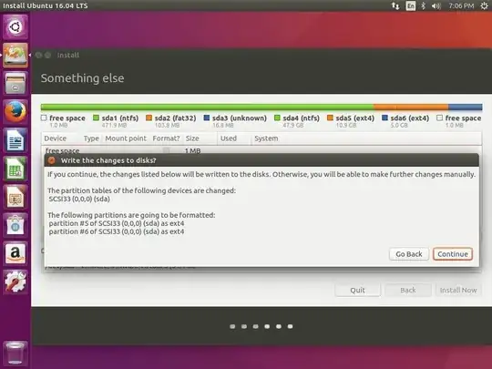

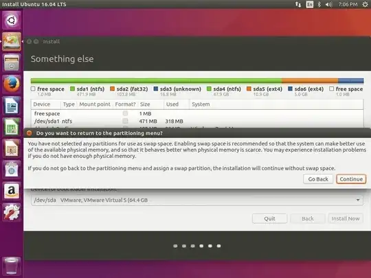

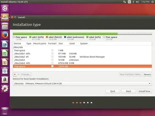

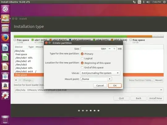

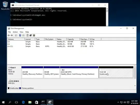

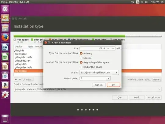

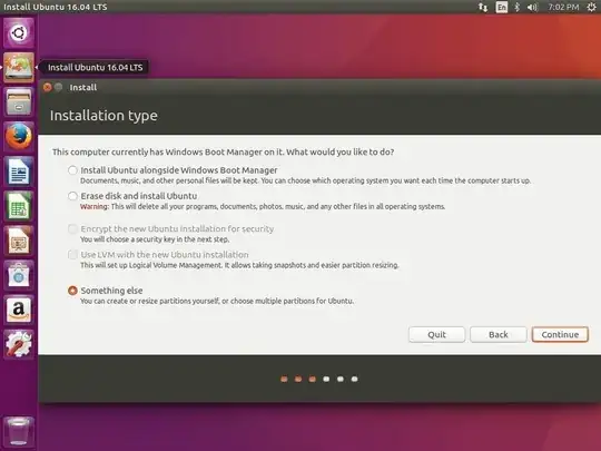

To dual boot your machine..ubuntu needs some unallocated memory. For that open disk management select any big disk and right click select option>shrink volume...type 70000mb(thats enough to run smoothly) and hit enter..u will get a black area as unallocated..now make bootable pendrive of Ubuntu shut down ur system boot ur pendrive using boot key and select usb select install ubuntu, going further u will get an option >install ubuntu alongside windows click it and go ahead..this should install ubuntu on your system (make sure both of them are in UEFI mode or one which your machine is running on(check in BIOS menu)) if it doesn't appear then choose "something else"option and you will have to manually partition unallocated (sample images attached here) enter image description here i will prefer install alongside if u wish to do it manually do these enter image description here
enter image description here enter image description here enter image description here enter image description here
Continue installation...reboot after completion.. hope this helps :)
