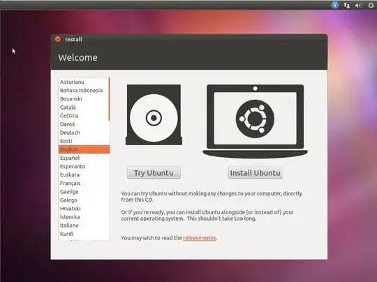

  6. Assuming you are not booting UEFI, press Shift once you get a purple screen with a picture at the bottom. Select your language with the arrow keys and Enter. Now, you should be confronted with a menu. You may try Ubuntu without installing, or you may install it. If you want to try it, choose "Try Ubuntu without installing", try it, double-click the Install Ubuntu icon on the desktop, and continue with this guide. Note that this test version is slower because it is running from a CD/DVD/USB, not your hard disk. Some versions of Ubuntu will give a graphical menu for this step.
    click "Install Ubuntu."

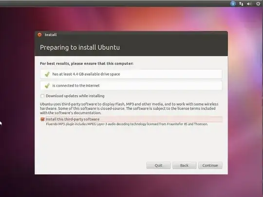

  7. Now, you will be confronted with a checklist. You may safely disregard the second option 'Install this third-party software', though Adobe Flash Player and some proprietary video codecs may not work, unless you enter the commands at the end of this guide.

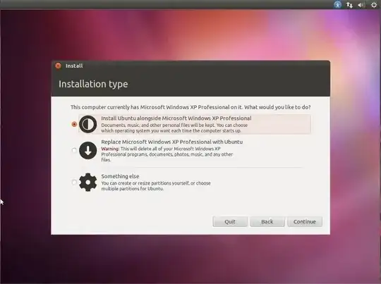

  8. Now it is time to partition your hard disk. If you want to avoid losing data or dual boot, this step is crucial. If you want to just clear out whatever is already on your hard disk, and use all of the space for Ubuntu, select that option, and skip to step 10. If you want to dual boot and trust the Ubuntu installer (not recommended), select the option to install side-by-side, and skip to step 10. If you want to manually set up dual boot, select the choice for advanced partitioning and proceed to the next step.
  9. Find your current Windows partition. It should be the first or second under sda, and its type should be NTFS. Click it once, and click Edit to invoke the partition settings dialog. Reduce the size by at least 40,000 MB, or more if you have extra free space on your old installation. If you have a separate Documents partition, you may resize that instead. Then click in the free space you have created and click Add, setting the type to Swap area, and giving about 1.5-2 times your RAM (Note that the input box takes sizes in MB, not GB.) You will now have swap space. Click in the remaining free space and add an ext4 partition with the default size (maximum possible recommended), and the mount point as /. You may also want to do a /home partition, which is where all your user files in Ubuntu will go. If you make a mistake anytime during this, click Revert.

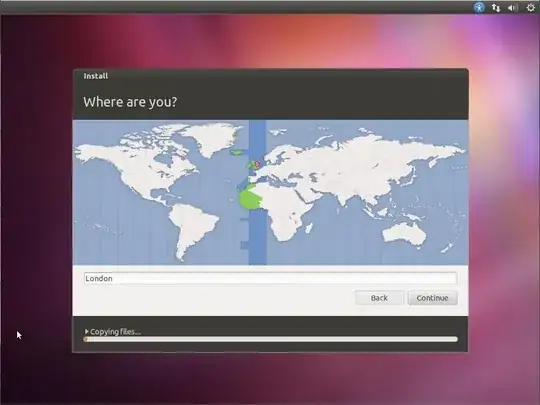

  10. We are now ready to install! Click 'Install Now', and allow the partitioning tool in the Ubuntu installer to write changes. Now you should be prompted to select a time zone. The Ubuntu installer wisely tries to guess your time zone, assuming you have a functioning internet connection.

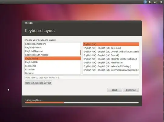

  11. You will now be confronted with a choice of languages again. Select your language, and on the next step, select your keymap (keyboard layout). If you are unsure, click on the button to detect your keyboard layout.

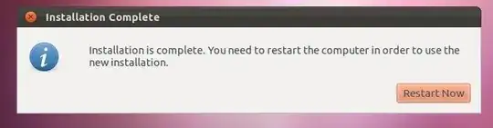

  13. Now you may sit back with no trepidation, until faced with the prompt stating the installation is complete.
