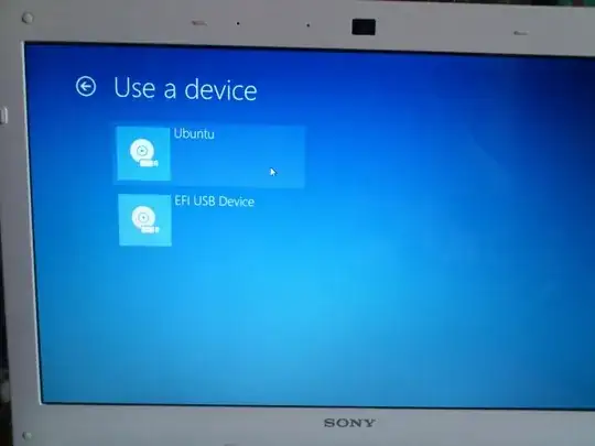

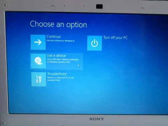

To get to the grub screen reliably, I am currently using the following awkward workaround:
  • While holding the SHIFT key, I click on Restart within Windows-8: enter image description here
  • When the menu below appears, I select Use a device: enter image description here
  • Then I select Ubuntu: enter image description here
Afterwards the GRUB menu appears and I can boot Ubuntu. For this to work I had to enable External Device Boot in BIOS and set in the Boot priority that the External Device (1) should be before the Internal HDD (2).
