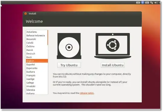

Just wait it for some time to load, then you'll see something like this:
Choose your language from the left, if you want to Try Ubuntu before installing it, then Click Try Ubuntu, and if you want to install Ubuntu straightaway, click Install Ubuntu, and you'll see something like this:

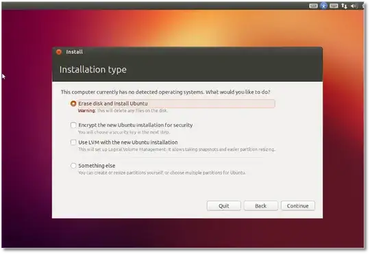

In your case, You'll have different options, choose Install Ubuntu alongside Windows

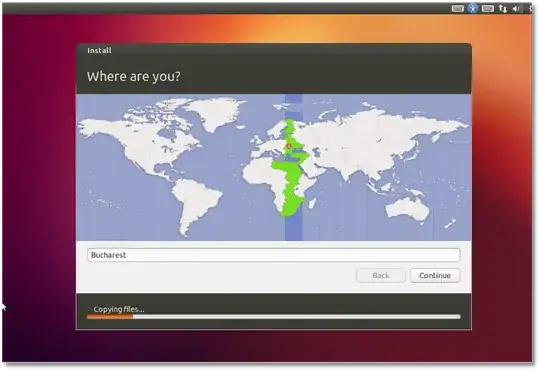

Typically, where are you? Just choose your country and click Continue, this is required to set the Time, date, etc.

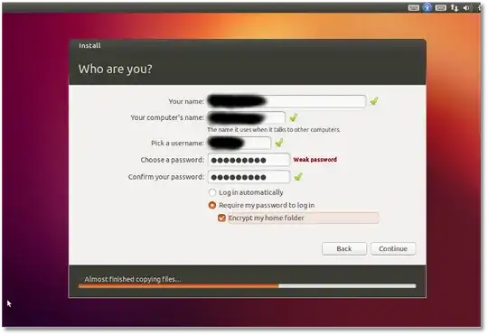

Add Your name and Your Computer's name, Pick up a username, Choose a Password, Choose login method, and click Continue

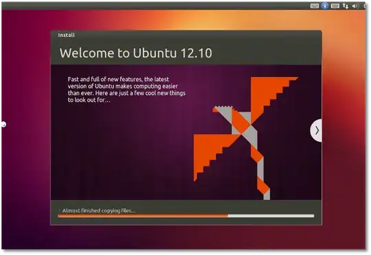

Now leave it to complete installing Ubuntu, after it finishes, you'll see something like this:

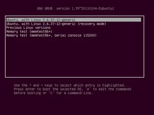

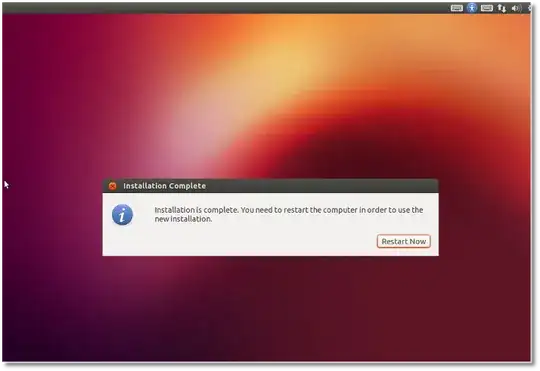

Just click OK, Eject the DVD, Reboot your computer, and you'll see something like:
10
Inn my case, i don't have Windows installed, however, you'll have another option to boot-up windows, and from here you can choose Whether to boot Ubuntu or Windows 8, Memtest and other options might become handy later
