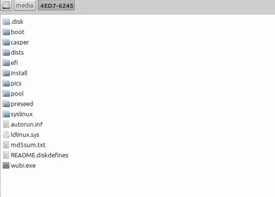

Wubi is still on the 12.04 CD but the ability to install inside Windows from CD has been disabled. The only way to do it is to run wubi.exe standalone available here.
For 12.04 they have simply hobbled wubi.exe to not offer the option to install, which you can bypass with a command-line option e.g. if your CD drive is D: you can go to a command line and run:
D:\wubi.exe --force-wubi

The daily 12.04 iso I have here when burnt has wubi. Get that, burn it and then open it in windows.
