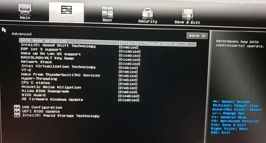

EDIT 2: I added a picture of the BIOS screen I am seeing here:
The value it was at was Intel RST Premium With Intel Optane System Acceleration. I then switched it to AHCIwhere I got the problems with windows not booting.

Have you tried to reboot windows in safe mode after the switch to AHCI? You need to have a complete boot on AHCI at least one time.
You can configure that with msconfig on windows before switching to AHCI: https://www.intowindows.com/4-ways-to-change-the-boot-order-in-windows-10/
Lu No
Source: http://triplescomputers.com/blog/uncategorized/solution-switch-windows-10-from-raidide-to-ahci-operation/
  •  Right-click the Windows Start Menu. Choose Command Prompt (Admin).
  •  If you don’t see Command Prompt listed, it’s because you have already been updated to a later version of Windows.  If so, use this method instead to get to the Command Prompt:
  • Click the Start Button and type cmd
  • Right-click the result and select Run as administrator
  • Type this command and press ENTER: bcdedit /set {current} safeboot minimal
    • If this command does not work for you, try bcdedit /set safeboot minimal
  • Restart the computer and enter BIOS Setup (the key to press varies between systems).
  • Change the SATA Operation mode to AHCI from either IDE or RAID (again, the language varies).
  • Save changes and exit Setup and Windows will automatically boot to Safe Mode.
  • Right-click the Windows Start Menu once more. Choose Command Prompt (Admin)
  • Type this command and press ENTER: bcdedit /deletevalue {current} safeboot
    • If you had to try the alternate command above, you will likely need to do so here also: bcdedit /deletevalue safeboot
  • Reboot once more and Windows will automatically start with AHCI drivers enabled.
