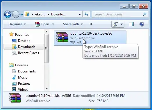

The file probably did not actually have a .rar extension. It probably showed no extension, and when you double-clicked it, it opened in WinRAR. That looks like this:
Windows Explorer, showing an Ubuntu ISO image as a WinRAR file, even though it is not a .rar file.

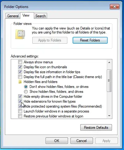

  1. Windows is configured to Hide extensions for known file types, which is the case by default.
    Folder Options in Windows 7, showing the "Hide extensions for known file types" option
    It's not necessary to change this setting, but if you want to do so, Folder Options is in Control Panel (in Windows Vista and later, it's in the Appearance and Personalization category).

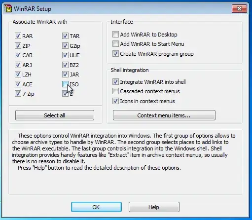

  2. WinRAR is installed, and configured to open ISO images.
    File associations in WinRAR setup.
    It's not necessary to change this either, but if you want to after installing WinRAR, open WinRAR and go to Options > Settings... and click the Integration tab. You can adust file associations there. You can also adjust them in the Default Programs applet in the Control Panel (it's in the Programs category).
