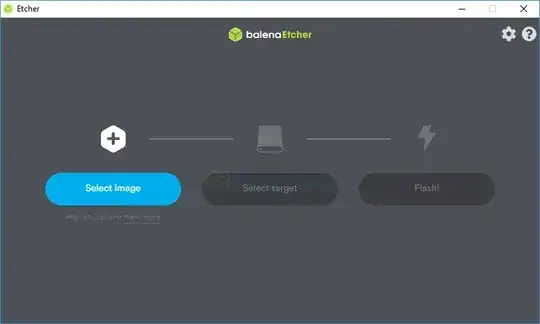

2.3. Open Etcher. You should see a screen like this:
Etcher
Tap the Select Image button and find your Ubuntu image (it should end with the extension .iso).
Tap the Select Target button and click your USB.
Tap Flash! and wait for the magic. Don't remove the USB yet.

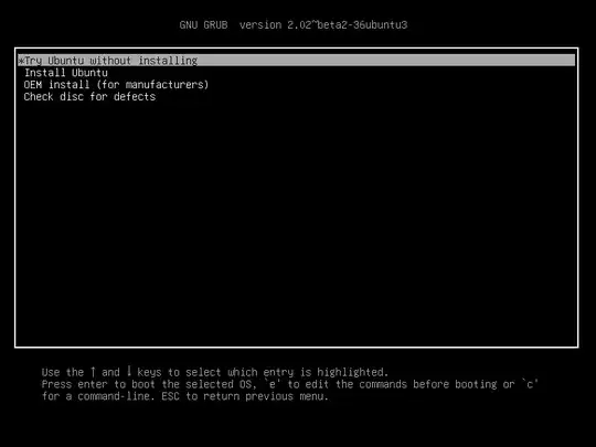

When you boot Ubuntu, you will see a screen like this: Ubuntu GRUB This is GNU GRUB, a bootloader. 4.1. Navigate to Install Ubuntu with the arrow keys and click ENTER. If it only shows an Ubuntu option, click Ubuntu.

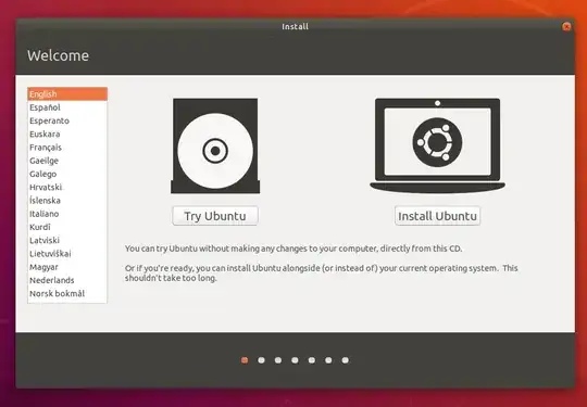

(funny number) 4.2.0. You will see a screen like this: Ubuntu's installer Ubiquity Click your language and tap Install Ubuntu and wait for the next setup to show, then click your keyboard and wait for the next one again, aka this: Install type 4.2.2. Click your preferred install type. I would use Normal for an average person, but if you just want to use it for tech, use Minimal.
