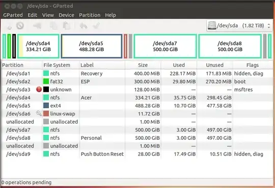

After following the boot-repair suggestion installed on the liveUSB, I can now see grub but can't log into windows anymore as it's not in the list. The boot-repair also completed with an error, i guess logged on pastin.ubuntu
How my drive is organized
gparted shot
