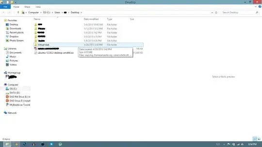

[ Image of the ISO ]

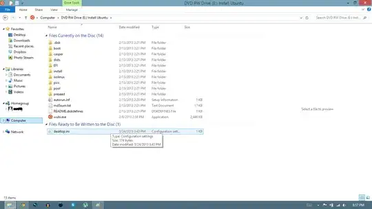

Image of the contents of the burned DVD.
Have I downloaded the wrong one as there is Wubi on the DVD?

That's the right ISO. There is a wubi.exe on it (just ignore it - it has other uses other than just installing inside Windows).
