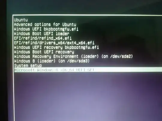

- While next starting up, it directly booted to Windows 8 and that happened repeatedly. The GRUB menu never really appeared. During trying to fix it, I hard shut down Windows 8 few times. I posted a question as well
- Then, I tried with "Boot repair" tool and finally the GRUB was back, I was able to login to Ubuntu without any problem

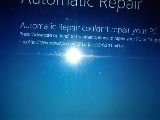

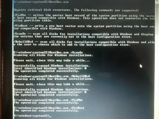

- Unfortunately, Windows 8 would never really boot after that; It will do some auto repair stuff and then give an error and then go back to the GRUB menu.

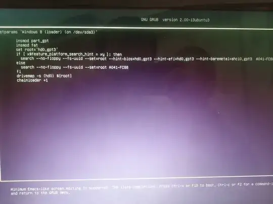

After searching numerous forums, there is no luck (from this forum too, I tried many suggestions which also include this thread and this thread). I tried every possible option, like editing the Windows 8 entry by pressing "E" and changing the current gpt3 into gpt1 till gpt8. But it always gives the same error:
can't find command 'drivemap'
invalid EFI file path
At the max after repairing, it reaches to the error which points out to 0xc000021a.

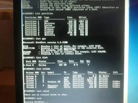

On other side, I don't have much data in Windows 8, but have lots in Ubuntu. As a final resolution, is there a way by which I can re-install Windows 8 without affecting Ubuntu partition?
I can still access Windows memory inside Ubuntu and here are some of the files which are appearing under "C:\Windows\System32\Logfiles\Srt":
Please let me know if something more is needed.

Here are some of the photos if they help:
