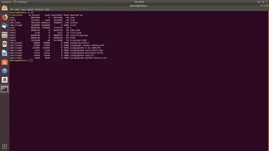

When I try to install Ubuntu it says I don't have enough space on my computer.
Also when I try to boot from USB it says there is no USB on the system, so I end up booting from linpus lite. I created a bootable USB using Rufus.

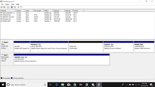

my df gparted windows partitioning
Can someone tell me what's wrong? Did I not allocate enough space on my drive or did am I not supposed to boot from linpus lite.

You are looking at the space on your USB Live Boot which is 7 GB.
In gparted you need to look at the unallocated partition after you Windows C drive. Here in your unallocated partition you have 103 GB free.
Select the option "Install Ubuntu alongside Windows" and you should have no problem pointing the installer to the 103 GB empty partition.
If you need more pointers follow this Q&A: How do I install Ubuntu alongside a pre-installed Windows with UEFI?
