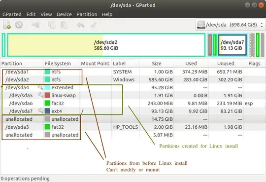

I have an HP Probook 450 G1 laptop with one HDD. I had Windows 10 installed. I wanted to be able to have a dual boot of Windows and Linux, so I created some partitions (100 GB for Linux, a 256 MB boot partition, and a 2GB swap partition) and installed Ubuntu 18. I remember being able to view my Windows partition and see the files on it. I then let Ubuntu update and assumed everything was fine. I don't have a recovery CD, but I do have the original Windows 7 installation CD that my computer came with.
I'm now seeing that:
  • There is not option to boot to Windows either from BIOS menu or from GRUB menu
  • I can see partitions in GParted, but I can't mount or modify any of the non-Linux partitions (/dev/sda1, sda2, sda3). I do see an option to format the Windows partition.
  • I can't access the Windows partition from Files explorer
  • I am not able to resize the Linux partition to take include the space that's labelled as "unallocated"
What I'm seeing in GParted
So far I have tried the following: Update grub Use Boot Repair application to reinstall and update Grub. I do see that Boot Repair finds Windows, but I don't see any change in behavior.
