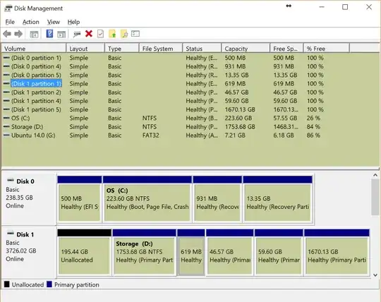

I installed Ubuntu using the method of 'something else', since I want to install it in another hard drive, which is HDD from my SSD where windows 10 is located. Here is a picture of my disk management, in which we can see disk 0 (C) is the windows drive (SSD), and disk 1 (D) is the HDD where I want to put Ubuntu in.
image of disk mangement
In disk 1, partition 1 is EFI, partition 2 is / mount point ext4 type. partition 3 is swap area and partition 4 is /home mount point ext4 type. And I chose the partition 1 (EFI, also sdb1) as Device for boot loader installation.
But as you can see from the image, all partitions I allocated for Ubuntu are 100% free and I do not know where Ubuntu is. This is the screenshot after I tried to install Ubuntu for many times, and every time I found they are still empty.

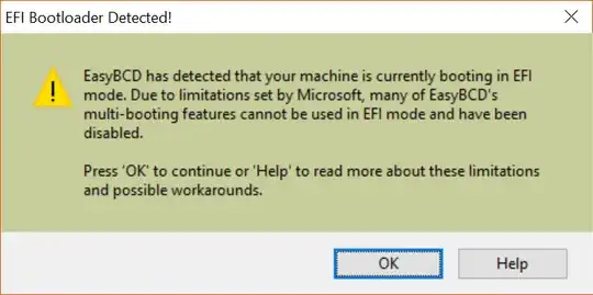

My booting configuration is: UEFI - secure boot off. I tried using EasyBCD, but got a warning like this:
image of easyBCD warning
So there is no way to add new entry for Linux option.
