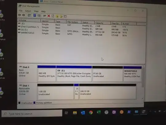

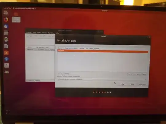

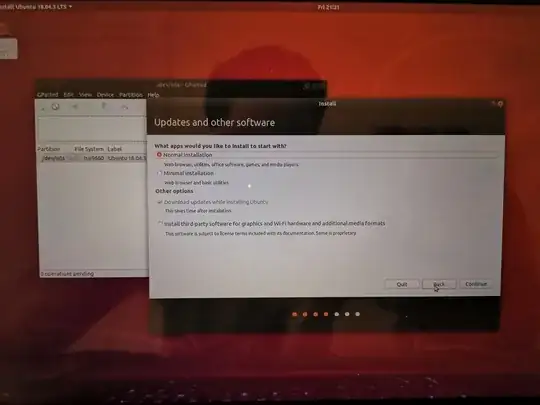

I cannot install Ubuntu 18.04 in my Dell Latitude 7400. I have followed four different tutorials and researched the problem, but the solutions haven't worked so far.
If I try Ubuntu from a USB it works fine, but when I install it I cannot find the disk I created neither the options on the installer to create the required partitions. From the research I did, it might be because my disk already has three principal partitions. I am not sure whether this is the problem or how to fix it.

Windows partitions in Windows
Windows partitions visible to Ubuntu
Ubuntu installation type

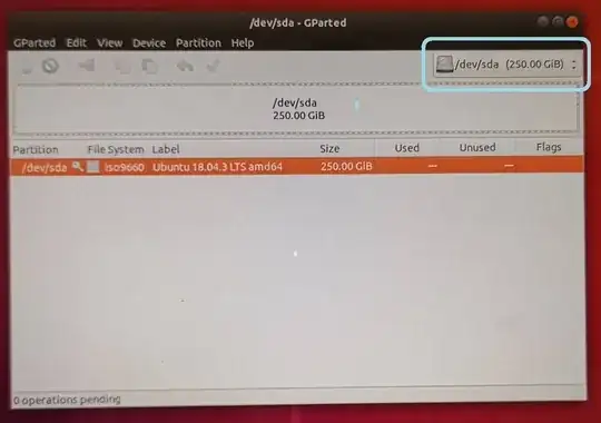

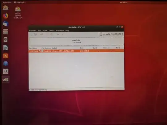

In gparted, change from your 250GB drive which identifies as sda to the 477 GB drive by clicking on the button circled in blue. enter image description here
You must change from /dev/sda because dev/sda is another disk entirely, not a partition of your boot drive, and your BIOS thinks it is a iso9660 disk, i.e., a removable optical drive.
Are you able to find the 97.66 GB unallocated partition? What is its name? That's where you want to install Ubuntu.
