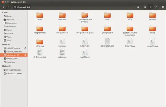

You can keep your documents, music and photos on your D drive if it's a separate hard disk of your C drive, not a partition on the same disk. Ubuntu will automatically mount such drive and all your documents will be visible to Ubuntu File Manager:
Look at my system below, I can see my windows drives:
