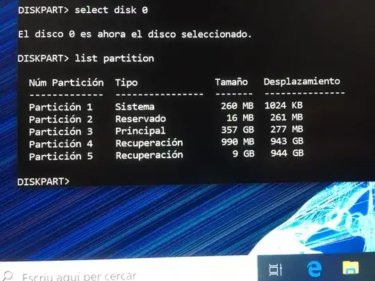

I also notice that list partition is not detecting Ubuntu's partition. I created a 600 GB partition and a 1 GB swap space in the missing space (it is a 1TB HDD), the partitions created would be between partition 3 and partition 4.

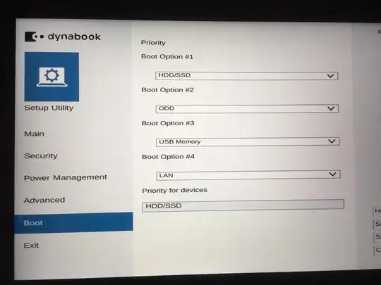

Boot options:

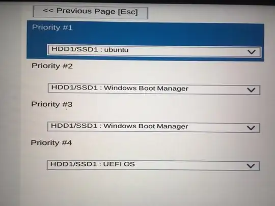

Current HDD boot options:
list partition output:
