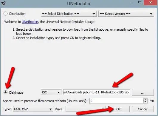

If your system can boot from USB, then you can use UNetbootin to create a bootable USB flash drive.
Either way you choose, once done, you need to set you BIOS to boot from either methods, to start the installation.
