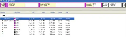

Resize your win8 partition and make a partition for win7 and some free space for Ubuntu,and install win7 in the partition. It is good to have a patition for data (so that it can be accessed in all 3 OS es, and it would be convenient if Ubuntu, Win7 and data are all in extended partition). This is how my partition table looks
Windows 8 recognizes Win 7 and a menu entry of win7 will be present in win8 boot menu. Now boot into Ubuntu live cd installer and use advanced option and select free space and select add option and make a partition for /, /home, and swap and install the bootloader in the respective / partition and remember the partition (like sda7). Once installed, do not restart, just close the window and open a terminal and run the following command
