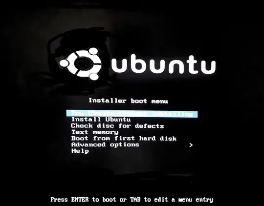

I am trying to dual boot Ubuntu with windows 10. My laptop is UEFI mode. I get this message when trying to install Ubuntu.
“The partition table format in use on your disks normally requires you to create a separate partition for boot loader code. This partition should be marked for use as a Reserved BIOS boot area and should be at least 1MB in size. Note that this is not the same as a partition mounted on /boot. If you do not go back to the partitioning menu and correct this error, boot loader installation may fail later, although it may still be possible to install the boot loader to a partition.”
I read the post here Ubuntu Error : "The partition table format in use on your disks normally requires you to create a separate partition for boot loader code" which says that I am installing in BIOS mode, but they also tell me to visit the website https://help.ubuntu.com/community/UEFI to shows install with screen shots for both BIOS(purple) & UEFI(grub menu), so you know which you are using.
This is the picture that I get when booting Ubuntu. So is this BIOS or UEFI? It looks UEFI. If it is UEFI then why am I getting the above message?

Simple solution is to create your OS bootable drive using RUFUS imager tool by selecting the partition scheme as GBT and its by default select the target system as UEFI only.
Pre-Requisites:
  1. Above method is for the laptops which comes with pre-installed windows with UEFI Mode.
  2. Disable secure boot, else every time when you boot into windows, it would ask you enter the "boot recovery key"
