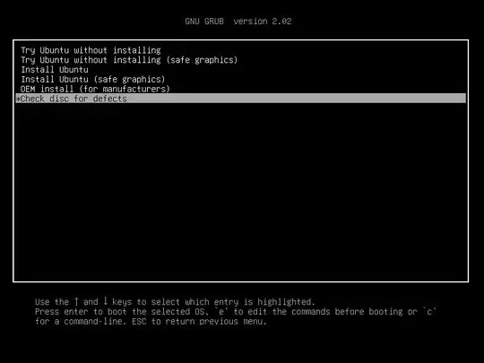

When you choose the boot device to boot from USB in the UEFI boot menu, select the UEFI USB option. You may see two USB options, one of them is UEFI-USB. Normal 64bit Ubuntu Live USB should detect UEFI and BIOS/CMS/Legacy and proceed accordingly. If this does not work, you may want to see How to create UEFI-only bootable USB live media?
If you boot from the LiveUSB in the UEFI mode you will see this screen:
