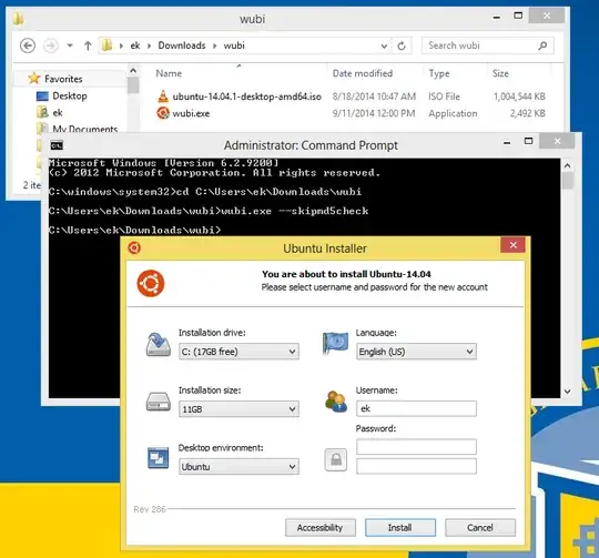

    If you know your ISO file is correct (for example, by checking its MD5 hash yourself) but the Wubi installer keeps rejecting it, you could run the Wubi installer with:
    wubi.exe --skipmd5check
    This makes it attempt to proceed with the installation even if it thinks the local ISO file is wrong. One way to do this is from a Command Prompt launched as administrator. (The .exe extension in the command is optional.) You'll have to cd to the appropriate directory first:
    Having put wubi.exe and ubuntu-14.04.1-desktop-amd64.iso in a folder by themselves, I start a Command Prompt as administrator (since UAC is enabled on this Windows system) and run cd C:\Users\ek\Downloads\wubi (you'll have to replace this with the correct location on your system) followed by wubi.exe --skipmd5check.

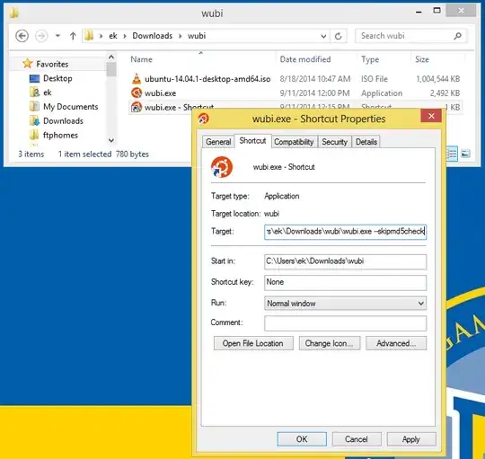

    Another way to run wubi.exe --skipmd5check is to make a shortcut to wubi.exe (right-click it wubi.exe, click Create shortcut). Then right-click the shortcut and click Properties. In the textbox labeled "Target:" add --skipmd5check to the end (make sure there's a space between ...wubi.exe and what you added).
    Running wubi.exe with the --skipmd5check command-line option by creating a shortcut and modifying the Target field in its Properties window.
    Then run the Wubi installer through the shortcut you created.
