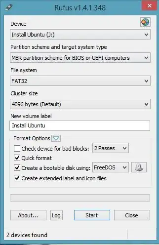

since you have a windows installation disk already, you can try this method... install windows, then recreate the live usb using the app rufus
Rufusmbrmode
remember to use MBR PARTITION SCHEME FOR BIOS OR UEFI COMPUTERS parameter while creating the usb disk. just select the device and the image file and other settings will automatically generated by the app
now try to install linux...it will work flawlessly
