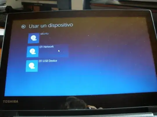

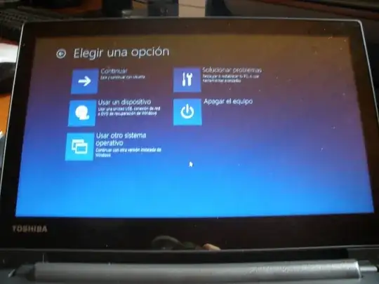

Which is already strange, as I thought the installation was in EFI mode (note- the secure boot option was disabled since the beginning, so this shouldn´´t be the cause). However after going to the "repair" options, the Windows menu appears (the same menu that allows to enter UEFI configuration), and in the "boot from device" option one additional figure appears- "ubuntu" which boots directly into the previously installed Ubuntu (14.04.1 LTS).

EDIT: Photograps of the boot process. After the error message I can go to the other windows menu and "boot from device"
