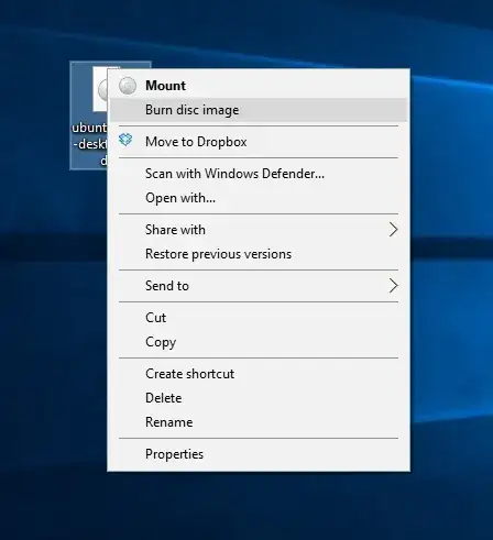

How to burn a DVD on Windows 7/8/10
  1. Right-click on an ISO image and choose Burn disc image.
    Burn disc image
  2. Select a disc burner (drive) and choose Burn. If you check Verify disc after burning, it will confirm that the ISO image has been burned correctly
    Select a disc burner and choose Burn

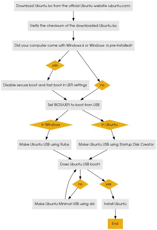

This flowchart shows how to make a bootable USB for installing Ubuntu and troubleshoot problems booting Ubuntu from it.
IMG:
Flowchart link
How to create a bootable USB stick on Windows
How to make an Ubuntu USB on Ubuntu
How do I make a bootable Ubuntu USB?
