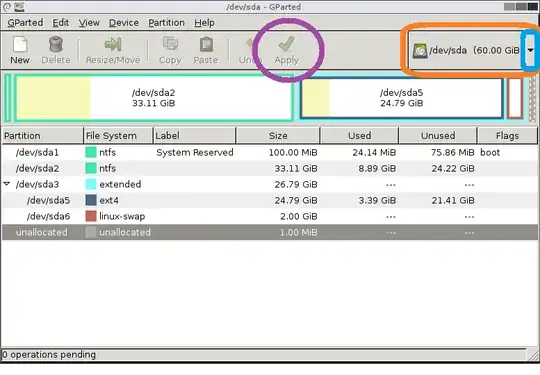

1) With the gparted program which comes with Ubuntu, choose the 2 TB drive (maybe it's /dev/sdb? Sometimes it's different; make sure you've got the right drive!).
The block in the orange box shows which drive you're looking at; the blue tab button shows you all available drives and lets you change the drive. When you start gparted, it will start with your system drive, probably /dev/sda, so you will need to change drives.
gparted screen
2) Resize the partition(s) on the 2TB drive and make a new ext4 type partition for Ubuntu's home. How big? Well, how big is your /home right now? In step 0 above, we found out, or you can open the Files app which comes with Ubuntu. Multiply that size by five or ten.
It's important to make one change at a time with gparted. You have to make room for your new ext4 partition for your new /home, before you can create it. Choose where you will put it, shrink the partition which is there now, then click on the check mark at upper center (in the purple circle in the picture) to actually go ahead and make the change.
Once you have made space, then you can create the new ext4 partition for your new /home; right-click on unassigned space, and create a new partition with type Primary, name /home, filesystem ext4, label /home, and click on the checkmark.
