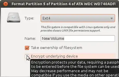

It's probably best to use a built-in solution like eCryptFS or LUKS. For an explanation about using eCryptFS, see the sites Jorge points to.
LUKS encryption is easy to set up with the GNOME Disk Utility; just tick the encryption checkbox at the bottom of the "format partition" dialog:
Screenshot of Format Partition dialog
The difference between both is that eCryptFS encrypts files (including the filenames), while LUKS encrypts a complete partition under the filesystem level.
Ubuntu can then remember your password when mounting if you want, allowing you to just plug and play on your device after logging in.

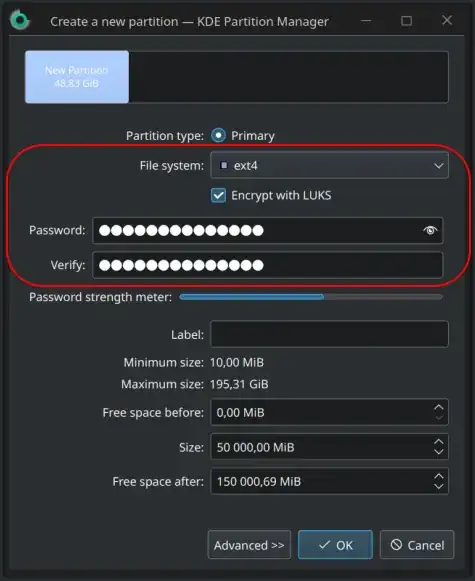

To add to JanC's great answer, for those using KDE, creating an encrypted partition with the built-in KDE Partition Manager is also as easy as it gets.
Just click on unallocated (you need to have some free space on your disk, of course), then New. From there for 'File system' you can select ext4 (that's the most commonly used file system in Linux), tick 'Encrypt with LUKS' and enter a password. Set the desired partition size, click OK and then, in the main window, click the Apply button.
You can then easily mount/unmount your new partition from Dolphin (it should be listed in a section called Devices).
