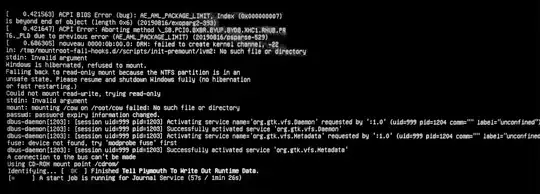

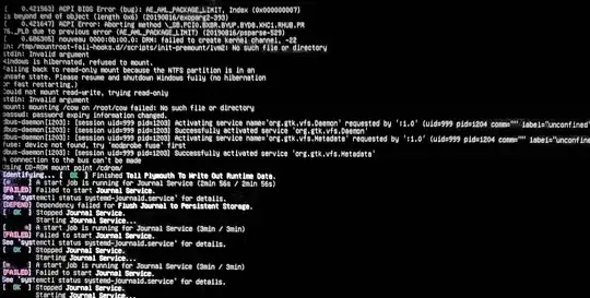

Updated with a picture of the screen I have been stuck on for 4 hours. This is the loop. If there is a way to access a CLI from here, I don't know how to access it.

Loading with the NTFS format doesn't work. Still in a [FAILED], [DEPEND], [OK] loop. besides see systemct1 status systemd-journal.service no other errors seem to be showing up.
So I ran the commands in the GRUB terminal and it kicked out an error. Although if I am reading it correctly, I am missing the device folder in my install. Also Windows won't turn off. I swear Microsoft is just trying to brick this machine.
